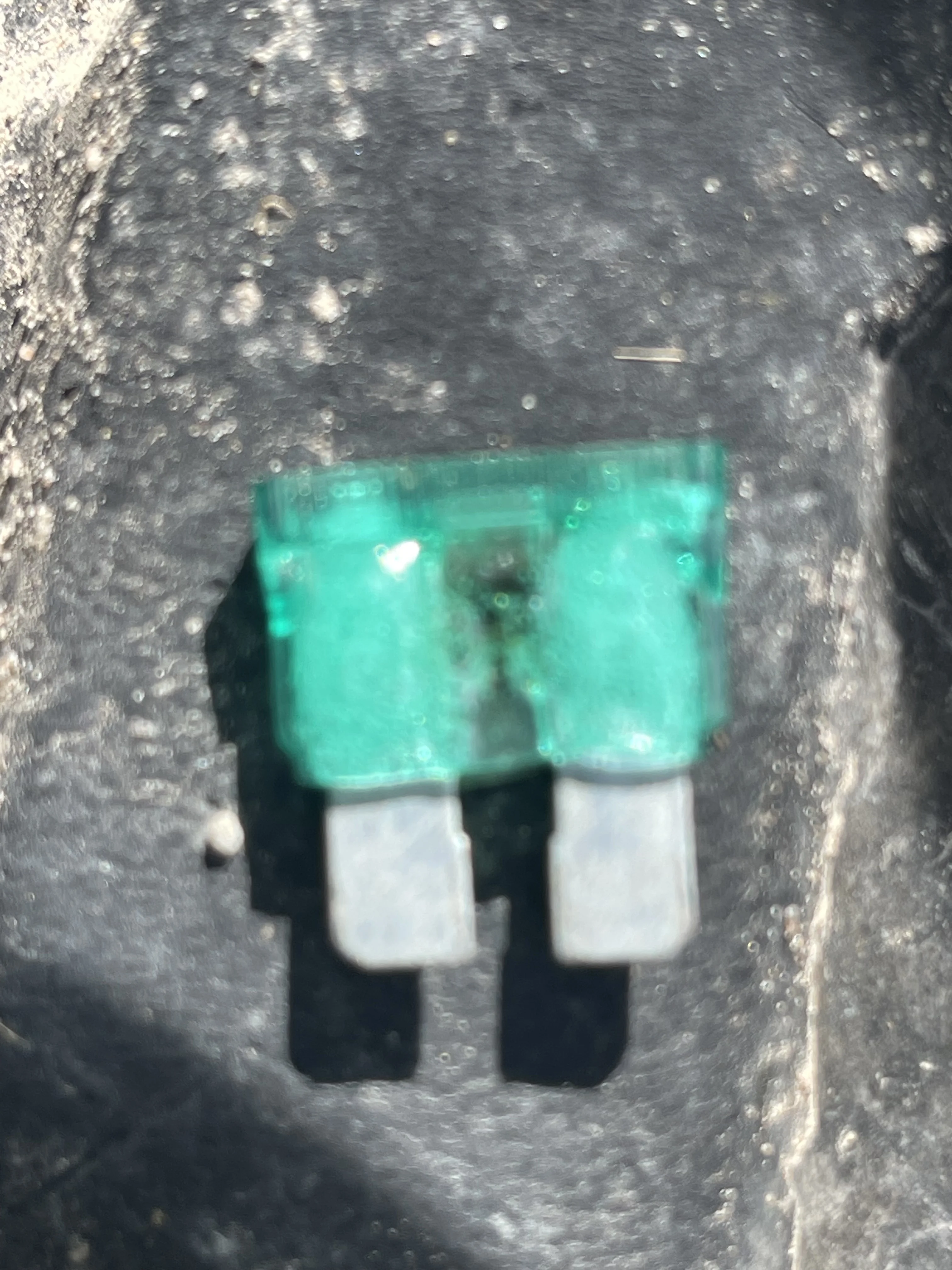

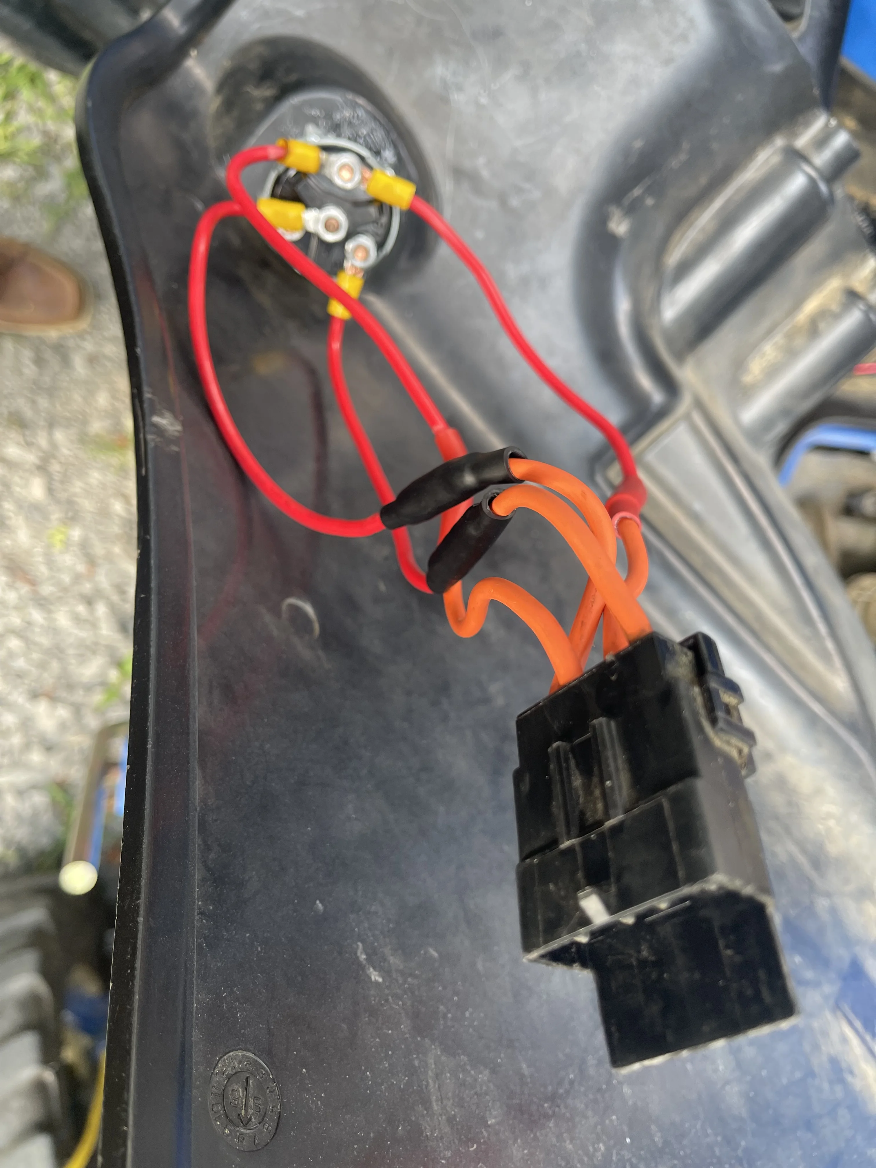

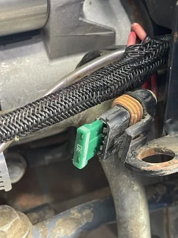

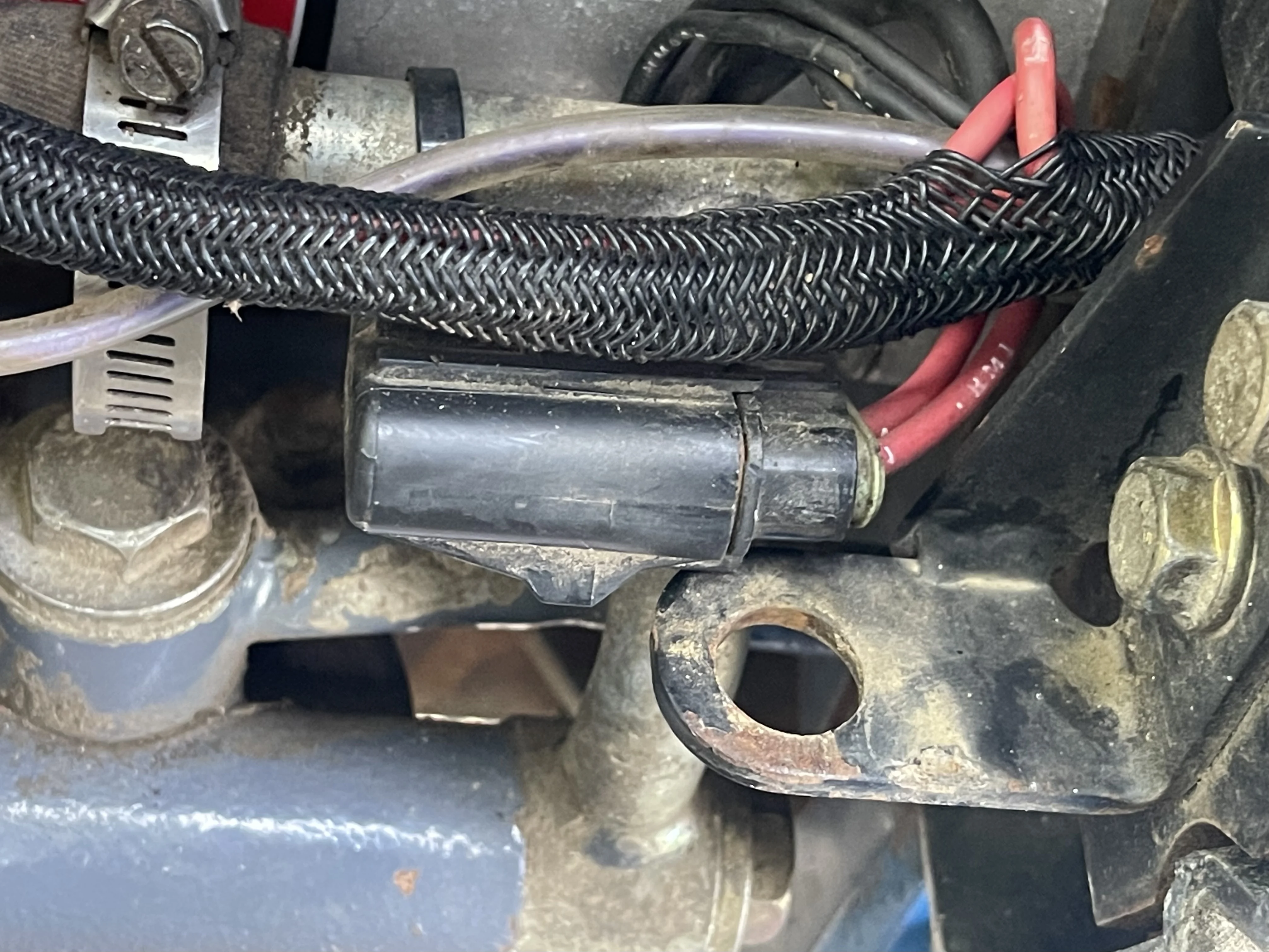

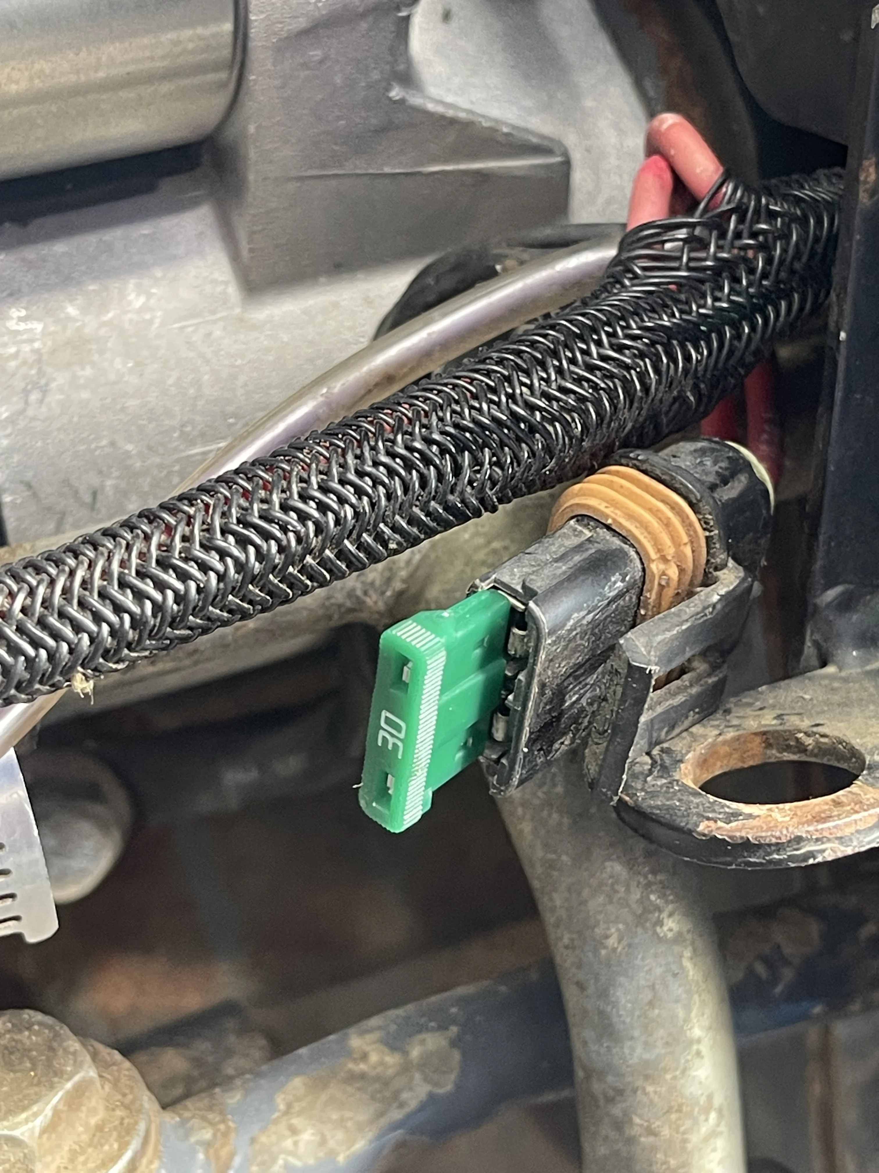

I had an issue with my TC33D tractor engine just shutting off, I tapped the ignition switch area hard I was able to start it it stopped I tapped again it started till I got back to my cabin. I drove the tractor down the driveway again and the tractor engine shut off and would not start. While replacing the ignition switch I noticed one wire was loose and had pulled out from the ignition switch. It looked like the wiring harness was to short causing the wire connectors on the ignition switch to constantly be pulled. While installing a new ignition switch I added 6” of 10 gauge wires to the 4 wires going to the ignition switch to relieve the pulling tension. The 30 amp fuse by the starter was blown so I replaced it. After these fixes I ran the tractor for 2 hours and so far no issues.

I had an issue with my TC33D tractor engine just shutting off, I tapped the ignition switch area hard I was able to start it it stopped I tapped again it started till I got back to my cabin. I drove the tractor down the driveway again and the tractor engine shut off and would not start. While replacing the ignition switch I noticed one wire was loose and had pulled out from the ignition switch. It looked like the wiring harness was to short causing the wire connectors on the ignition switch to constantly be pulled. While installing a new ignition switch I added 6" of 10 gauge wires to the 4 wires going to the ignition switch to relieve the pulling tension. The 30 amp fuse by the starter was blown so I replaced it. After these fixes I ran the tractor for 2 hours and so far no issues.
