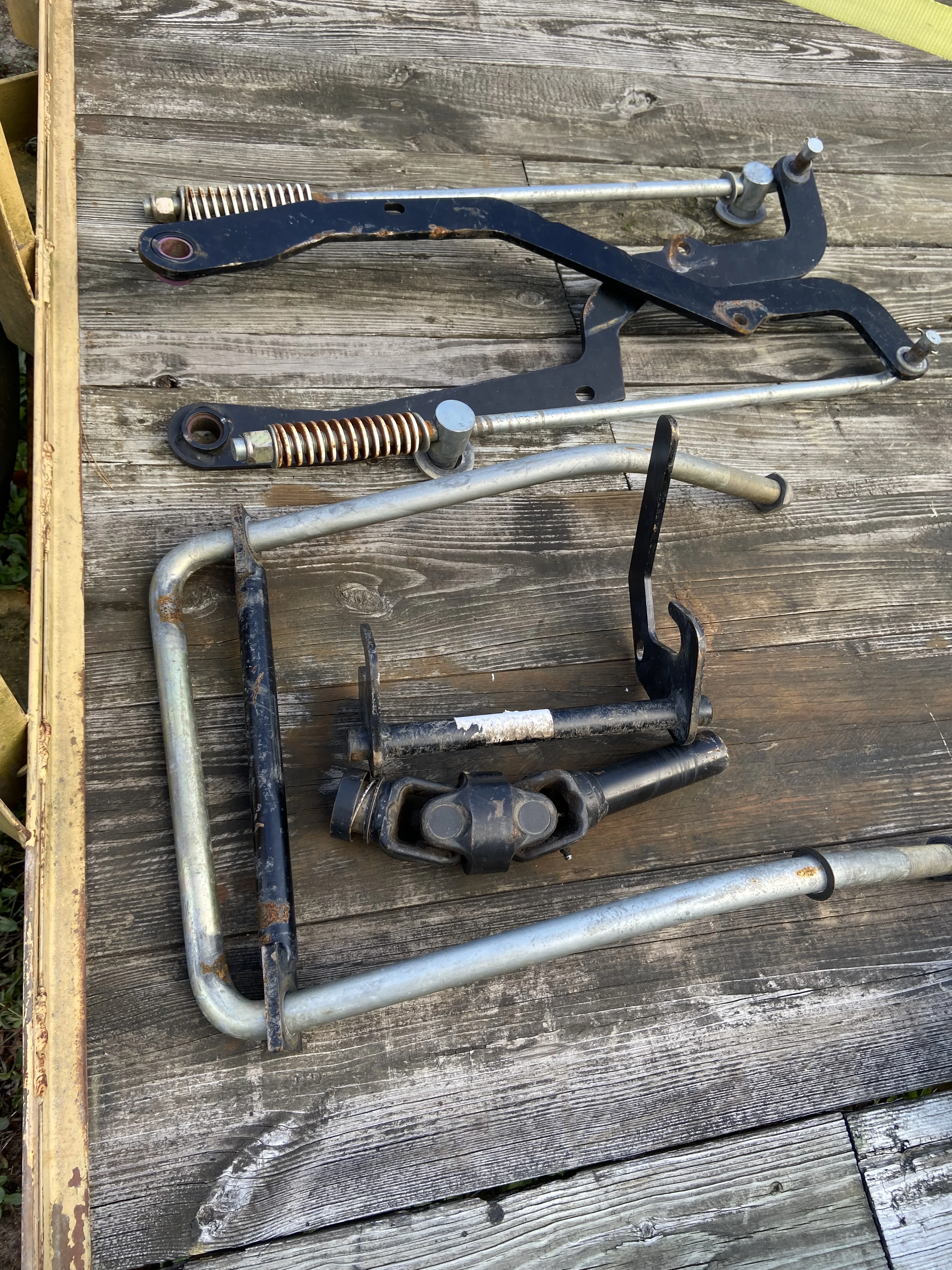

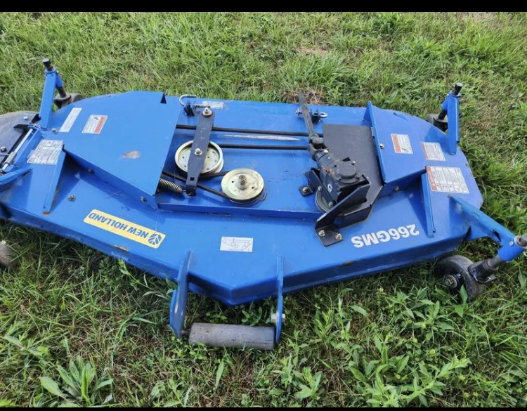

So I am looking to add a 266GMS Mower Deck to my 2020 35 Boomer, and sure having a rough time finding a dealer that knows how to get a list of the necessary mounting hardware that's required.

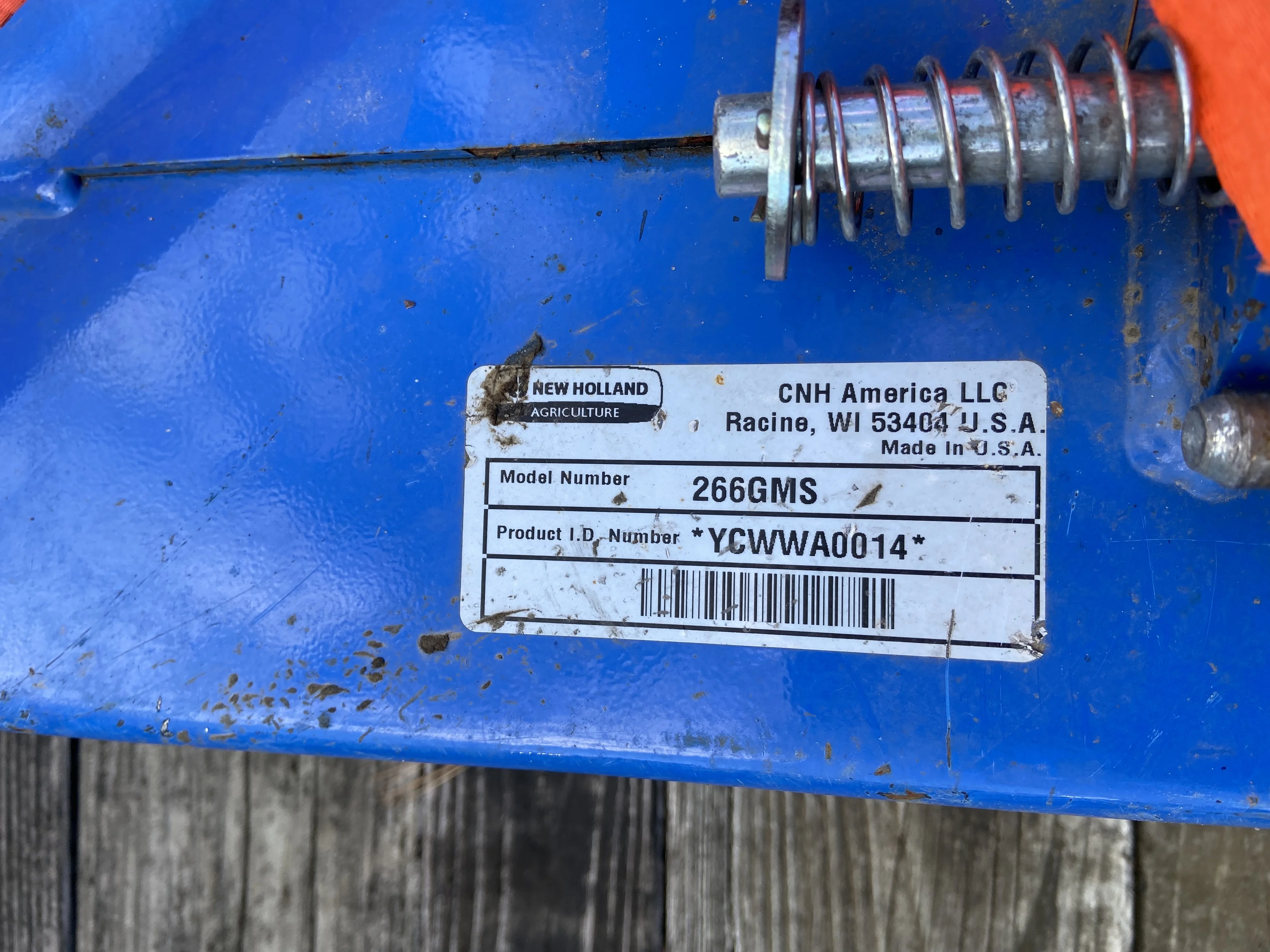

For a 2020 Boomer 35 (which typically falls under the "Class 3" or newer chassis series), you are looking for specific mounting groups. There are two "generations" of the 266GMS, so you'll need to check your deck's serial number.

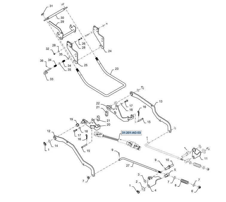

Component GroupCritical Parts Often Missed
Lift Linkage KitPart # AMENHM612: This is often the "master kit" that includes the mid-linkage arms, hangers, and the specific M14 bolts required to tap into the tractor frame.
Front HangerPart # AME453010B (RH) and AME453015B (LH): These are the "Upstop" hangers that mount to the front of the mid-frame.
PTO DrivelinePart # AME451170B / AME451175B: The yokes and shaft that connect the tractor's mid-PTO (under the belly) to the deck gearbox.
