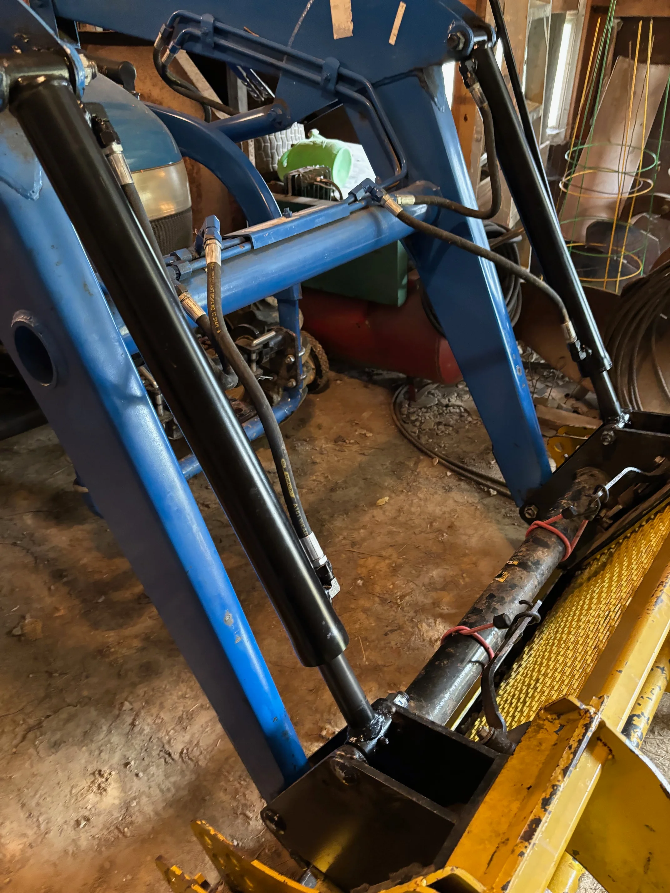

interesting post. I just this morning ordered 2 tilt cyl. from Westendorf to fit this TA111 loader. I ordered lift cyls. to replace the tilt cyls which are identical to the tilt cyl. except the ram is 1/38" as opposed to the 1" in the tilt cyl. The stroke is 21" in both cyls. which is not to be had aftermarket. The price will almost make you bleed $838 ea.

Nice job on matching the stroke length, it's not easy to find aftermarket parts that meet that spec. I'm excited to see how they fit. Appreciate the pic.

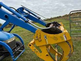

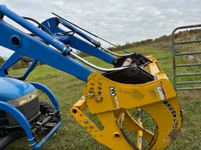

Could not find aftermarket in 21"stroke. I'm sure the manufacturer planned it that way. These are identical to the lift cylinders. Fit perfect. when I unboxed the cyl. I thought the ram had been painted black also, but find the whole ram has this gun metal like coating. I have never seen a cyl. ram that didn't have the chrome finish. Anyone else?

Interesting! I’ve yet to see a gunmetal finish on a ram. Can’t help but wonder if that’s a choice for durability or just a way to cut costs.
